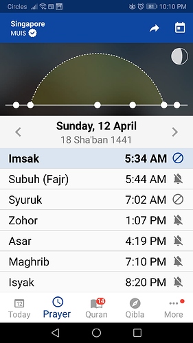

Fajr is 8 min late, while Dhuhr is 1 minute early.
On HA:
Screenshot 2020-04-12 at 10.09.53 PM
Actual Salah timing in Singapore:

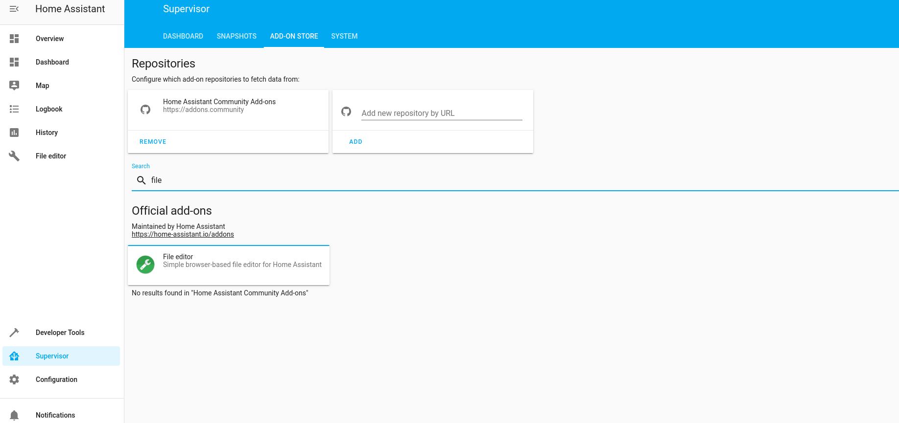

I am using two audio files. The audio files can be downloaded from the link https://gofile.io/?c=1ymMjM
The files should be uploaded to “www” folder under config.
You can install file editor addon to work with files. See screenshot below.
After doing all, restart your server. Hope this helps.
