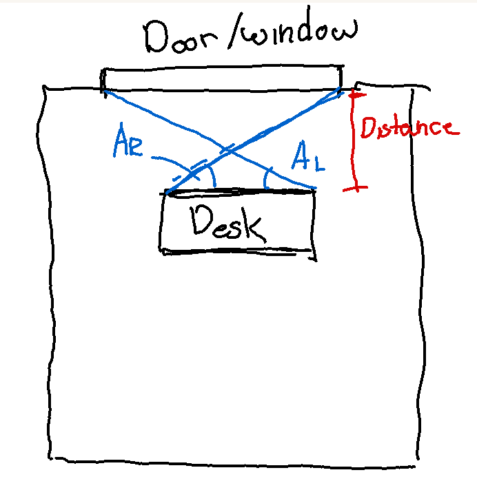

Sorry about the poor quality images, but I think it helps explain the idea better. I would love your thoughts on improvements or if you think its a waste of time…
The first part would be to get the Ar and Al azimuth left, azimuth right. These are taken from one edge of the desk to the opposite edge of the door or window. This should give you a range of when the sun would be coming directly though the window.
Using the distance from the window, as well as the height of the window… This would give you a range of solar elevation that the sun would come through the window.
From here you know that each half of the curtain would cover half of the azimuth range we have calculated… So if its under the half way point, we would close the left, over we would close the right… Then we can calculate the percentage of the azimuth range where the sun is for the half of the curtain we would be closing, add 5%? and close the curtains to that point.

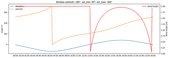

Simulation for that location says this:
So at 8:00 the blind should be almost closed. Is that what you would expect?
Yes, but it’s not what I got, the blinds opened all the way.
