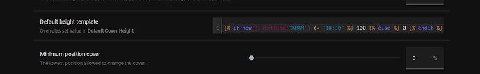

I still have problems with the rear window, and as you can see in the picture, the window is completely full of sun, but the window was only set to 34% open
the azimuth is 225* over openstreetmaps. Have you perhaps a idea?
the template code is correct in this format?
because when i edit the automation in yaml he escapes the ".
default_template: "{% if now().strftime('%H%M') <= \"18:30\" %} 100 {% else %} 0 {% endif %}"
If you want more shade then you have to set the distance from the cover to shaded area lower (distance). Also check the picture in the original post.
Yes that should probably work, be aware that the default gets reset to 100 at midnight with this condition. What would result in opening the covers just after midnight when the sun has changed position.
ah, okay, thanks for the info, I’ll turn off the automation in the evening, but just for the sake of correctness, i should define from XXX to XXX, right?
