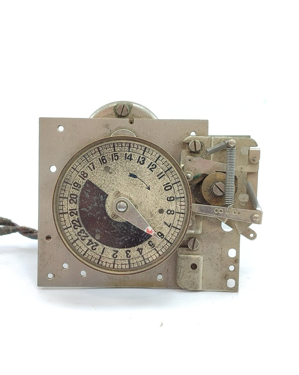

Automation old-fashion timer

“automation as a old fashion timeswitch like” how to, if possible?
