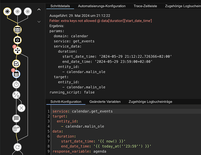

Phew, that is by far more advanced than anything I did before, thanks for giving me something to learn :). I just blindly copy and pasted this, changing the calendar to the right entity to test it and give this a proper study the next days. But the traces show this
:man_facepalming: I forgot to erase the duration line… I’ve corrected it in the post above.
I am sorry for being a pain and I feel to hijack this post which was really not my intention!
With the duration deleted it gives me this for the variables block
Fehler: TypeError: decoding to str: need a bytes-like object, LoggingUndefined found
