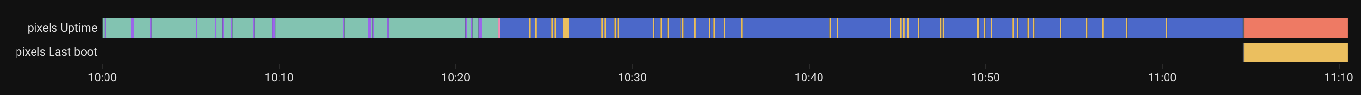

I don’t know why it is spamming the activity log. What is the activity? Uptime I understand, but that only needs to update with a time stamp when it boots?
If I use the uptime entity to trigger something, it will trigger all the time, not just when the awtrix display starts, right?
I might misunderstand the concept.

This looks much better. No activity log spamming with useless state changes.

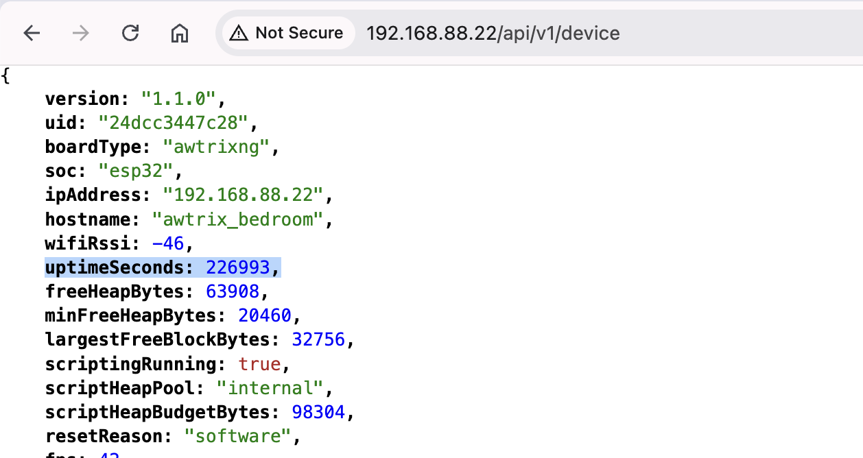

What is now the difference between the Uptime and the Last boot timestamp?
Both currently show the same value because the device hasn’t rebooted since either was last updated - but they update very differently:
  • Uptime recomputes every poll and rounds to the minute. It keeps ticking/refreshing on its own even without a reboot (as time passes, it stays “how long ago the device booted” - it’s a live “time since boot” readout, so its displayed value can shift by a minute here and there).
  • Last boot is a fixed timestamp that only changes when the device actually reboots (detected as a >30s jump in computed boot time). Between reboots it never fires a state change - so it’s safe to use as a reboot trigger. Uptime is not, because it updates on its own schedule too.
OK … I don’t see Uptime updating, but I personally don’t mind, since I don’t need the uptime to be calculated since the time stamp is in the state of both Uptime and Last boot. Maybe there is something I don’t understand, but I am still curious why we see different things for the Uptime entity.
and btw fixed.
