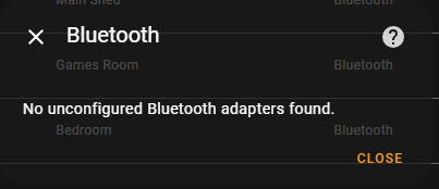

I’m on ESPhome 2025.6.1 and have the bed sensor in my ESPhome builder panel so I think that means “adopted” (normally I just create my own devices from scratch) but yet I still don’t have it as a BT Proxy…
If I go to add a device to my list of BT Proxies it gives this:
Yet the bed sensor is not in the list.

Yes, that means you have it adopted and won’t receive manage firmware updates. Compare your yaml to sensor-configs/bed-presence-mk1.yaml at 34cf8dcf48f6874ac1ba628c6b2b74458adf54d2 · ElevatedSensors/sensor-configs · GitHub, and make sure you include the following line in the files being pulled in as a remote_package.
- 'esphome-common/bluetooth-proxy.yaml'

I thought the main package would include the BT stuff…
Exactly the same as here.
As advised by Stephen I just now compared its yaml to the github version, added the missing lines and recompiled. BT-proxy gets detected and works like a charm now on the bed presence sensor.

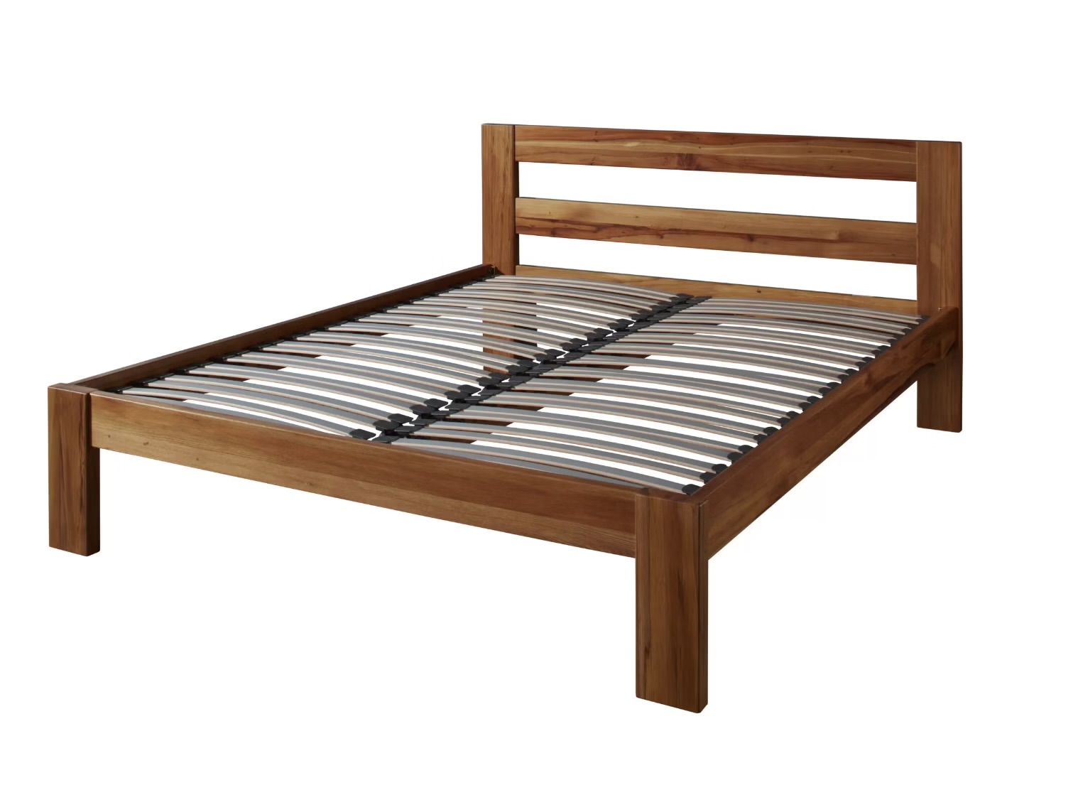

hi There, just checking in on this. We have a king size flexible slat base like this picture. Topped by a standard mattress. The slats are wide enough with also enough space between them. Will your sensor work with this type of base? Note that the slats are mounted to the frame with a little rubber mount.
That’s the same sort of bed frame we have and the sensor works flawlessly.

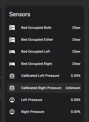

My sensor has stopped properly working on one side. If I press on the strip by hand it registers pressure so I figure the hardware is ok, but its always saying that sides calibration is unknown even after multiple attempts to run the calibration. I’ve updated the ESPhome version a couple of times since but no change.
Any ideas?
Yes, that type of bed is compatible. Since it has the support in the middle, you’ll either want to use the included extensions strips and mount the main unit under the slats, or purchase the Universal Mounting Kit to keep everything above the slats.
What’s the name of the entity that’s reporting unknown?
sensor.bed_presence_2d1dfc_calibrated_right_pressure
Even after running the calibrations it never seems to adjust the right side percentage.
We found that the “calibrated” entities cause more confusion than value, so we disabled them by default in a firmware update. I’m not sure why one would still work and one stop working though. It might be worth disabling the entity, then enabling it again if that’s a value you care about. Otherwise, I would recommend disabling both of them.
