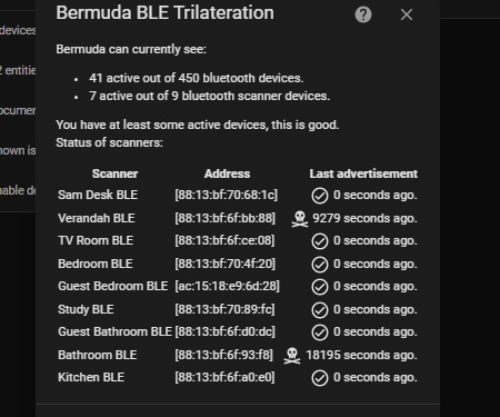

The esphome integration already has a “watchdog” system in place so that it can request proxies to restart if they stop sending advertisements. The main idea of these particular sensors is to give you a good idea of whether all your proxies are working, and to help identify if some are not sending updates as often as they should - this is often indicative of bad firmware settings, but causes may vary.

Yes, your diags look good as far as proxy health goes - your intervals are typically around 1s or so most of the time. Your distances however are pretty large, and looking at your phone in the kitchen over the last 10 seconds of that diags, the distance bounces from 5m to 21m, which is fairly variable.
