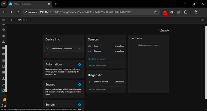

I’m trying to use BT/BLE, I started recently and would like some help.
I put the configuration below on 3 esp32 boards, 1 for testing and the others where I use other sensors:
bluetooth_proxy:
active: True
esp32_ble_tracker:
scan_parameters:
interval: 1100ms
window: 1100ms
While I wait for some BLE devices to arrive, I enabled the Monitor Beacon (I don’t think it’s necessary) and BLE Transmitter sensors in the companion app on my android.
I installed and configured Bermudas and added the BLE Transmitter UUID.
The problem is that sometimes all Bermudas sensors become unavailable, I believe this is happening after restarting the HA so I have to reload the integration manually.

What am I doing wrong?
Your interval and window settings are wrong, unless your esp32 has an ethernet connection.
This is causing the esp32 to crash or lose wifi connection, as it doesn’t leave any time for the radio to service other tasks.
Good settings are documented in the wiki, that should get you up and running: ESPHome Configurations · agittins/bermuda Wiki · GitHub
