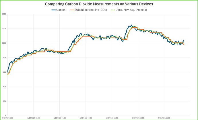

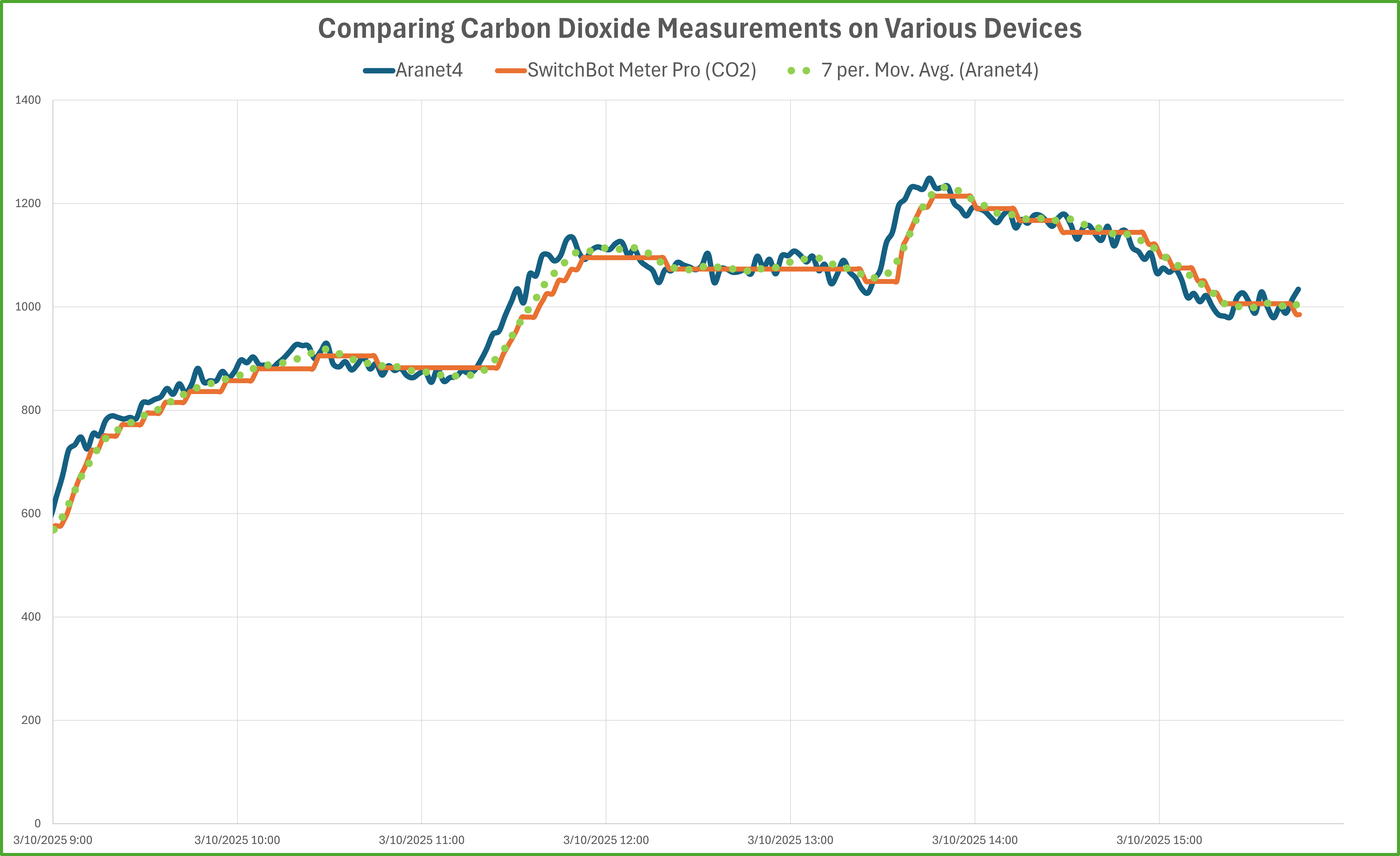

I compared the Aranet 4 (which has become a fairly popular device) with the SwitchBot Meter Pro (CO2 Monitor) - the latter being about 1/3 the price of the former.
The Aranet is great with portability, quickly detecting changes (like walking into a crowded arena or classroom), and the battery life is great. It is more expensive.
The SwitchBot only updates every 30 minutes when running on battery, so it is essentially useless if not plugged in. That being said, it can update every minute if connected to USB power.
I compared readings for the two devices during a day in my classroom, providing a range of values and quick changes. Aranet data was exported for two-minute intervals; SwitchBot data at one-minute intervals.
For stationary (home, work) readings where there are unlikely to be significant quick changes, and where it can plug in, the SwitchBot seems to be a decent option for reliable CO2 measurements.
I’ve attached an image of the direct readings from Aranet and SwitchBot, along with a 7-point moving average trendline for the Aranet. In this case, the lines are quite similar, which possibly suggests the SwitchBot is averaging readings - but shows reliability even if it is slower to respond.

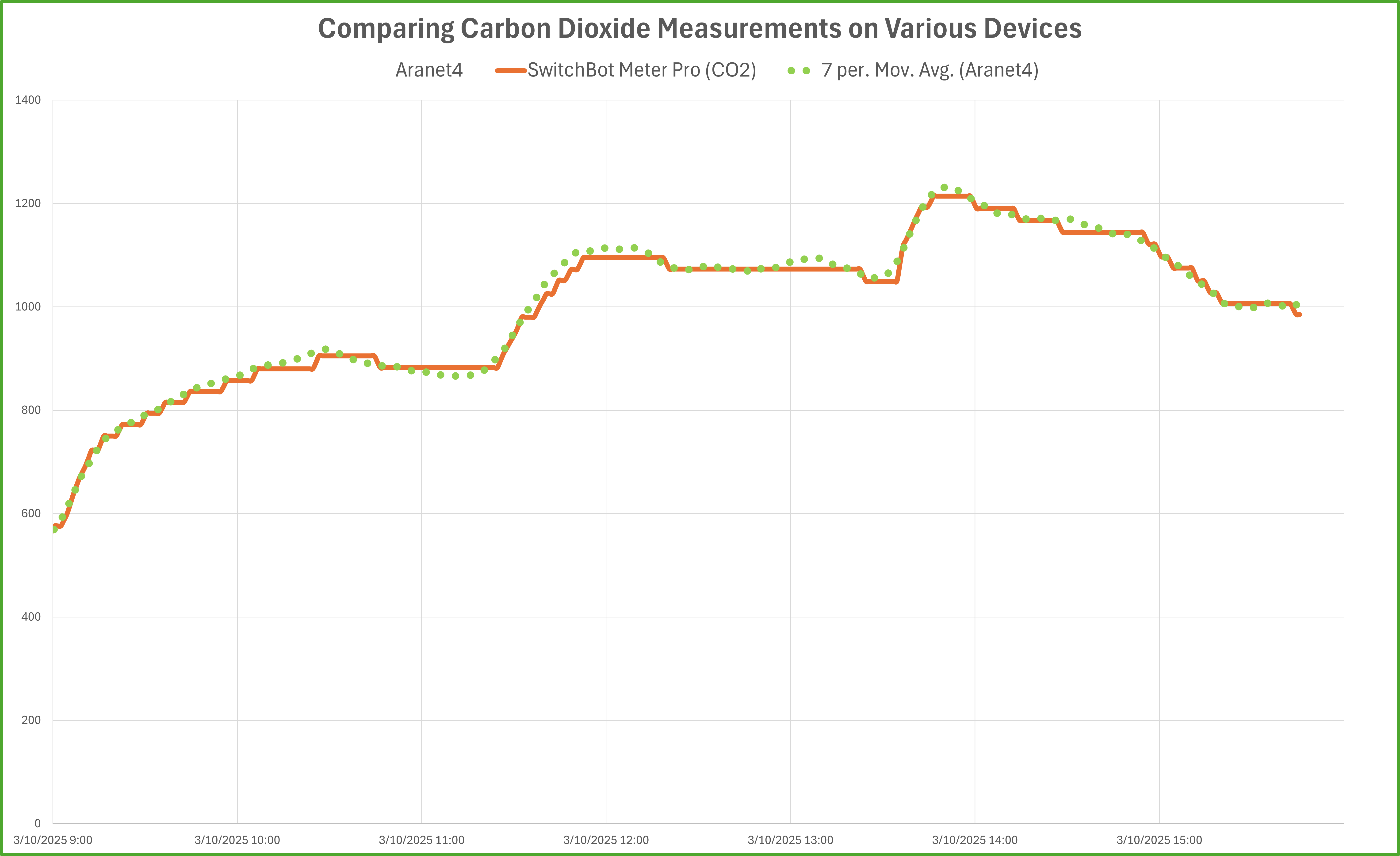

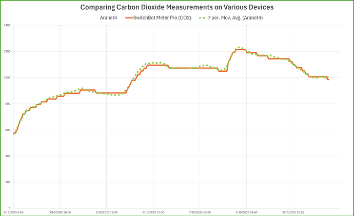

This is only the Aranet trendline and the SwitchBot data.

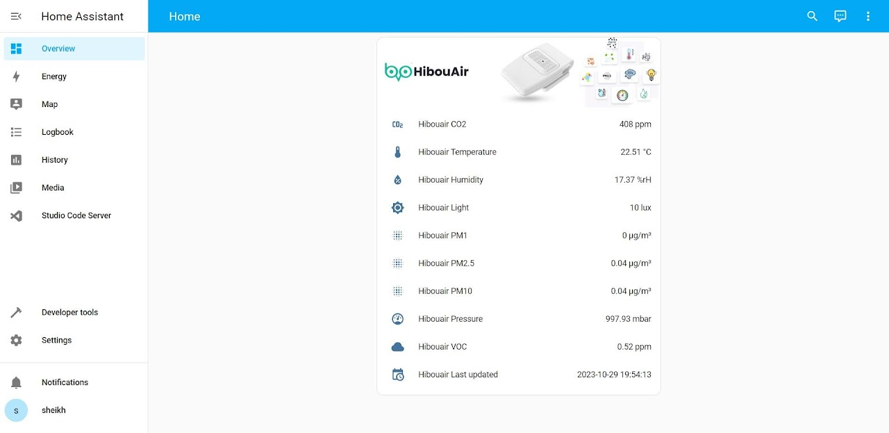

I have used HibouAir CO2 monitor. which is comparatively cheaper. like you mentioned i get other parameters like pressure, temperature humidity, voc along with co2.
i have integrated it with Homeassistant .
