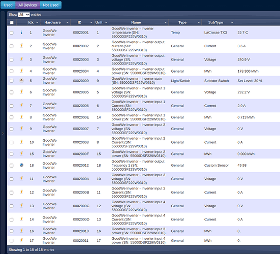

Ultimately my goal is to gain direct access to my new GoodWe inverter locally, but despite trying several times to request GoodWe support to upgrade the ARM firmware it doesn’t appear to have happened. I am also not sure how I work out if the ARM firmware has been upgraded? I assume there would be a change in details on the inverter?
In the meantime I managed to gain access to my inverter data in a round about sort of way, via a Domoticz plugin that queries the GoodWe SEMS website via an API. The data is coming to Domoticz, so now I have the dilemma of interfacing between Domoticz and Home Assistant.
My old inverter required a similar setup, with Domoticz capturing the data from my old inverter directly, and supplying the data to HA via MQTT. So I figure I should be able to do something similar?
Only issue… my old inverter provided the data in Watts and it appears the new inverter provides KwH. Here’s the code I used for my old inverter…

The code above basically converted the Watts (from my old inverter) into Kilowatt Hours. So I figure because my new inverter provides kWh (see item 8 in the picture above) I should be able to somehow tell HA that the data coming in is measured in Killowatt Hours? The data from my previous inverter was fed into the Energy Dashboard, so I’d like to do the same. I figure it should probably just be a tweak of the code above?
Would really appreciate some advice, I just need a bit of guidance and I should be fine.
