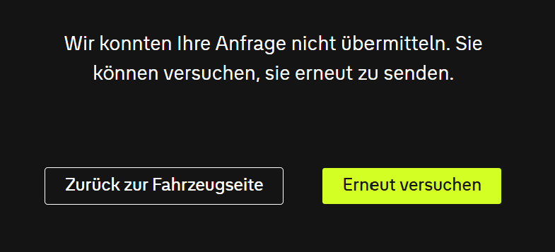

I will test with a Golf 8 as well, as soon as I don't get "request failed" messages from the portal. :sweat_smile:

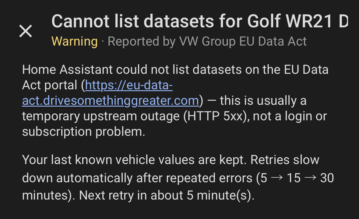

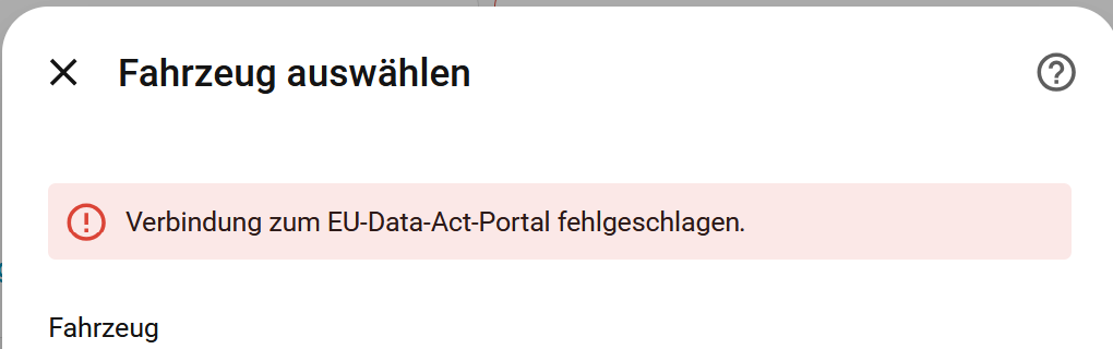

I rebooted HA this morning at 6:00 am and now have this error. It’s now 9:00am.

For me it looks like there's a current problem on the portal, for my both cars last files where received >20 hours ago.
Also In portal itself no files are visible.
@roudini , @cameron I thought it's only for me but indeed last file I had after 16pm yesterday (GMT) but while ago got new one again.

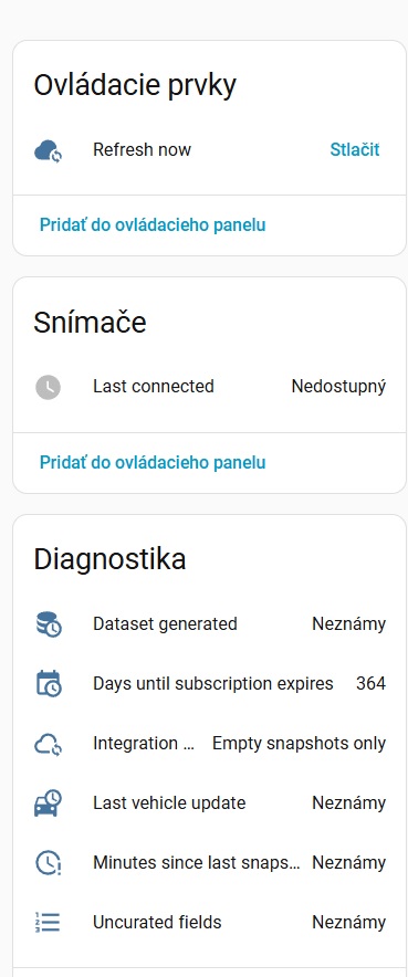

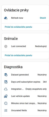

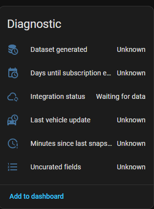

I have added the VW ID.7 vehicle, but it only finds these entities.
Hi @levican506 — thanks for testing with the ID.7.
What you’re seeing is expected right after setup, not a broken integration. Your screenshot shows Integration status: Empty snapshots only — login and the portal subscription are fine (364 days left), but the portal has only delivered empty _no_content_found snapshots so far, so Home Assistant has no vehicle fields to create yet.
The entities you see are the built-in diagnostics (status, subscription, timestamps, etc.). Real sensors (battery, temperature, charging, …) appear automatically once a ZIP with actual telemetry arrives — no need to remove and re-add the integration.
We already have a successful ID.7 test in this thread (@jnehrk): full data worked after the portal started delivering real snapshots. Other testers saw a similar slow start (e.g. ~11 entities first, ~120 after a few hours / overnight).
Please double-check on the portal:
• Continuous 15-minute request active for this VIN
• Dataset All Data (not only Charging)
• Vehicle linked under Data clusters → Vehicle overview
• Car recently online (ignition, short drive, or open the VW app)
First real data is often 15–60 minutes, sometimes a few hours. Empty snapshots are normal when the car sent nothing in a 15-minute window.
If it’s still only empty snapshots after ~24 h with the car awake, let us know the integration status value and whether the portal shows real ZIPs (not only _no_content_found).
Thanks!
Tommi

That is different from HA showing listing_failed (HTTP 5xx, no datasets at all) — but both point to VW infrastructure, not the integration.

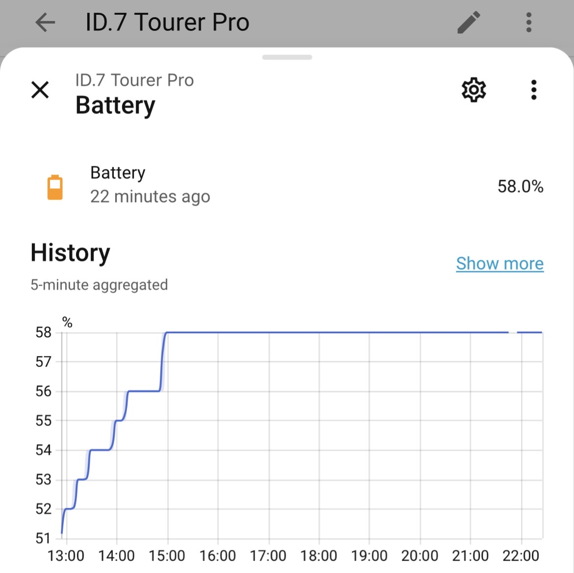

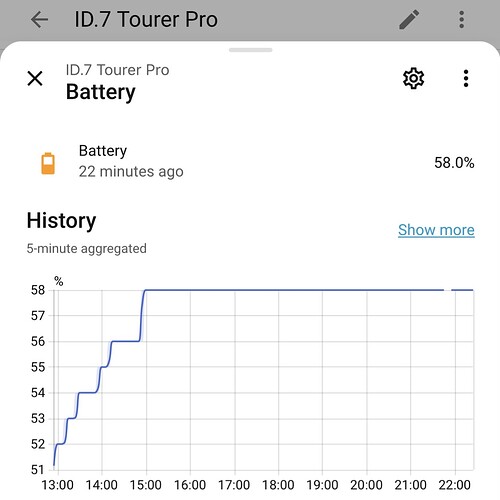

I’ve got exactly the same as you described. Already reinstalled the latest version but no difference.
The app tells me the current battery range is 87% but the VW EU data act json still report 58% since 15.00u today
