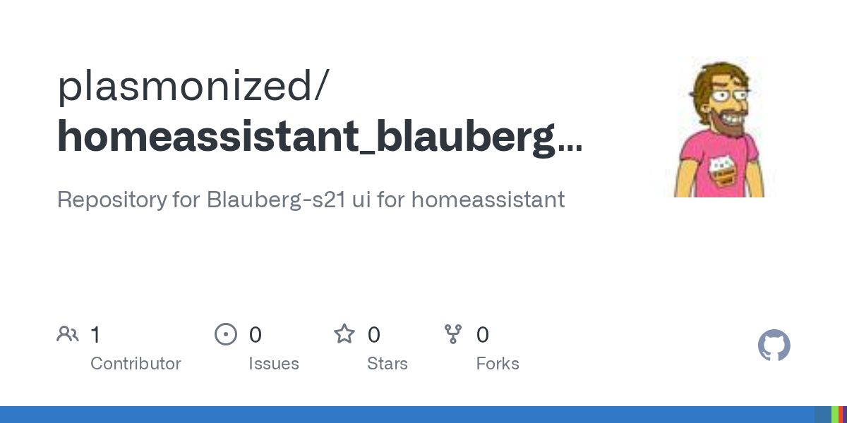

hey guys,
i just vibecoded this app for homeassistant which is totally capeable to control the S21 over modbus because i was unhappy with the previous solutions:
you can add this app by adding this link as acostum repository in the apps and you can just install it.
There is the posibility to control the S21 with external sensors you have already installed in the house and outside and the control will take this to change the ventilation accordingly. also, there are diffent modi to control the S21, example to avoid to much humidity, or regarding temperature or CO2.
There is also the possibility to use a switch or motion detector to switch on the boost mode (toilet boost etc…)
It could be possible that it has some bugs left, I will eventually fix them if i find the time!
Best
Alex

Hi vic. I bumbed a new version with mqtt connection status and optional mqtt connection. Its not tested jet, but you can try it. Aswell i included some new features which i think are helpful… specific external sensor selection for automatisation and mean sensor calculation out of different sensor values…
Actual version 0.2.11
