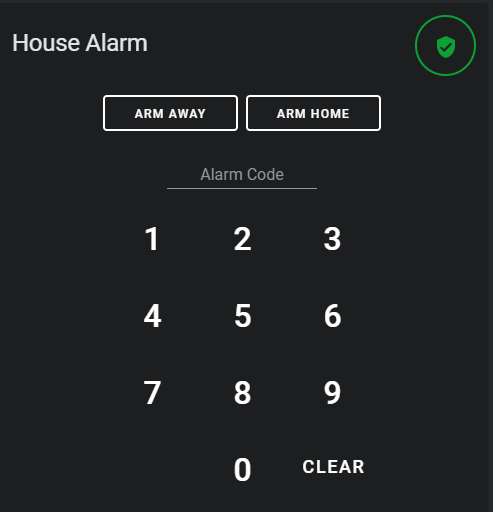

When you use the alarm panel, the default lovelace skin has a red badge on the top right corner to show the alarm is active (screenshot 1). Is there a way to have the same badge show up here? Currently it just comes empty (or maybe black and it is matching with the background?) and you can’t tell when the alarm is armed.
Edit- I’m pretty confident the badge turns black and blends into the background.
Default Lovelace skin badge
Capture3
This Skin
As an FYI- when the alarm is not armed, it correctly shows the green badge
Thanks for your help.

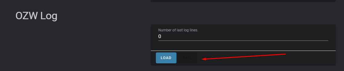

Also, disabled buttons are barely visible, for example on the Z-wave config page:
I do not think this part is themable yet! Waiting for future update.
