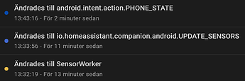

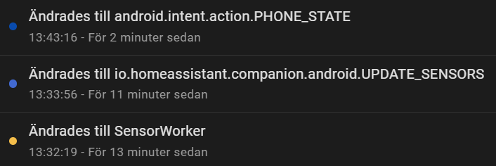

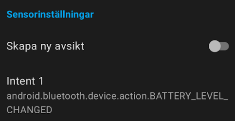

Hi, I have problem with the Indent settings for Last update trigger sensor.
Do you see something wrong here? How should i looks like in the sensor?
Using a Pixel 8 phone with android 16.
Seems correct.
Create the template sensor also and it should work
