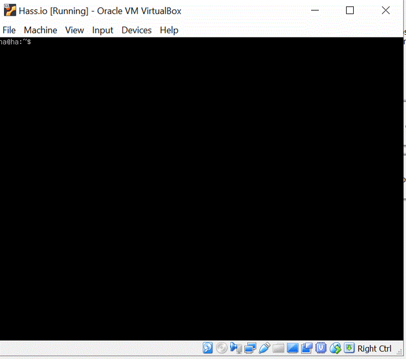

im running windows 10 , virtualbox vm running Hassio, i dont think that i have this option
In the command prompt in the VM, it doesn’t accept the command noted above?
If not, I would maybe check out the link up in the thread about how you can setup ubuntu server on a windows VM, then you can run a 1 liner to let it install hassio. From there you will have more control and it should allow you to install bluetooth as mentioned in my last reply.
