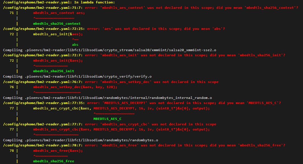

I was wondering if someone can help me.
I copied the YAML from Reverse engineering the popular BM2 BLE car battery monitor | CocoonTech.com and added it to the ESP32 device YAML. Note my ESP32 device YAML does not have a MQTT component.
When installing the YAML into the ESP32, I get errors:
