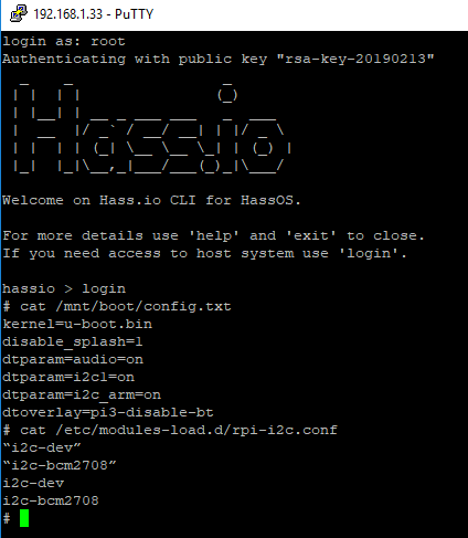

I understand it is the right one. However, after rebooting the system, the following error still appears
Wed Feb 20 2019 17:53:29 GMT+0100 (hora estándar de Europa central)
Error while setting up platform bme280
File “/usr/local/lib/python3.6/site-packages/smbus/smbus.py”, line 81, in open
self._fd = os.open(path, os.O_RDWR, 0)
FileNotFoundError: [Errno 2] No such file or directory: ‘/dev/i2c-1’

The installed sensor is the original Adafruit sensor, which always uses the 0x77 address (I checked it in a direct installation in another Raspberry). I also checked the jumpers connections.
I think I will desist from enabling this sensor in Home Assistant. But your patience and help have allowed me to learn new things and move forward. Again, thank you very much.
Looks like there is a formatting issue - when you copy the command here, it copies another type of quotation marks. Actually - my bad, I just could have skipped using them in my example.
You can fix your added lines by removing these quotation marks like this:
sed -i ‘s/\“//g’ /mnt/boot/config.txt && sed -i ‘s/\”//g’ /mnt/boot/config.txt
sed -i ‘s/\”//g’ /etc/modules-load.d/rpi-i2c.conf && sed -i ‘s/\”//g’ /etc/modules-load.d/rpi-i2c.conf
Just tested and looks like the same problem is with these commands. You need to replace these “smart” single quotes with the straight ones in these 2 commands above. Hope you can manage it.
After this just make sure the quotes are gone and then reboot
I have managed to do this.
Now, the error message does not appear and in Home Assistant I can see the three sensors of temperature, humidity and pressure.
vitaalz, using your commands, I get the error: "unsupported command".
With the suggestion of rubendijk, not removed the quotation marks, but I added the two correct lines.
Now I have to reconfigure Lovelace and later I will try to learn about templates.
Thanks a lot to both of them. Their patience is comparable to that of Job (the biblical character)
