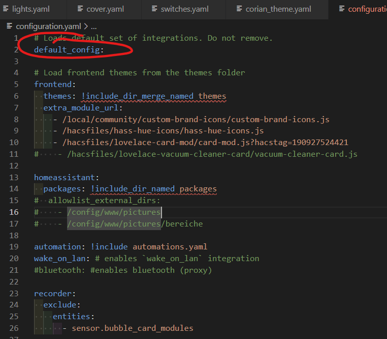

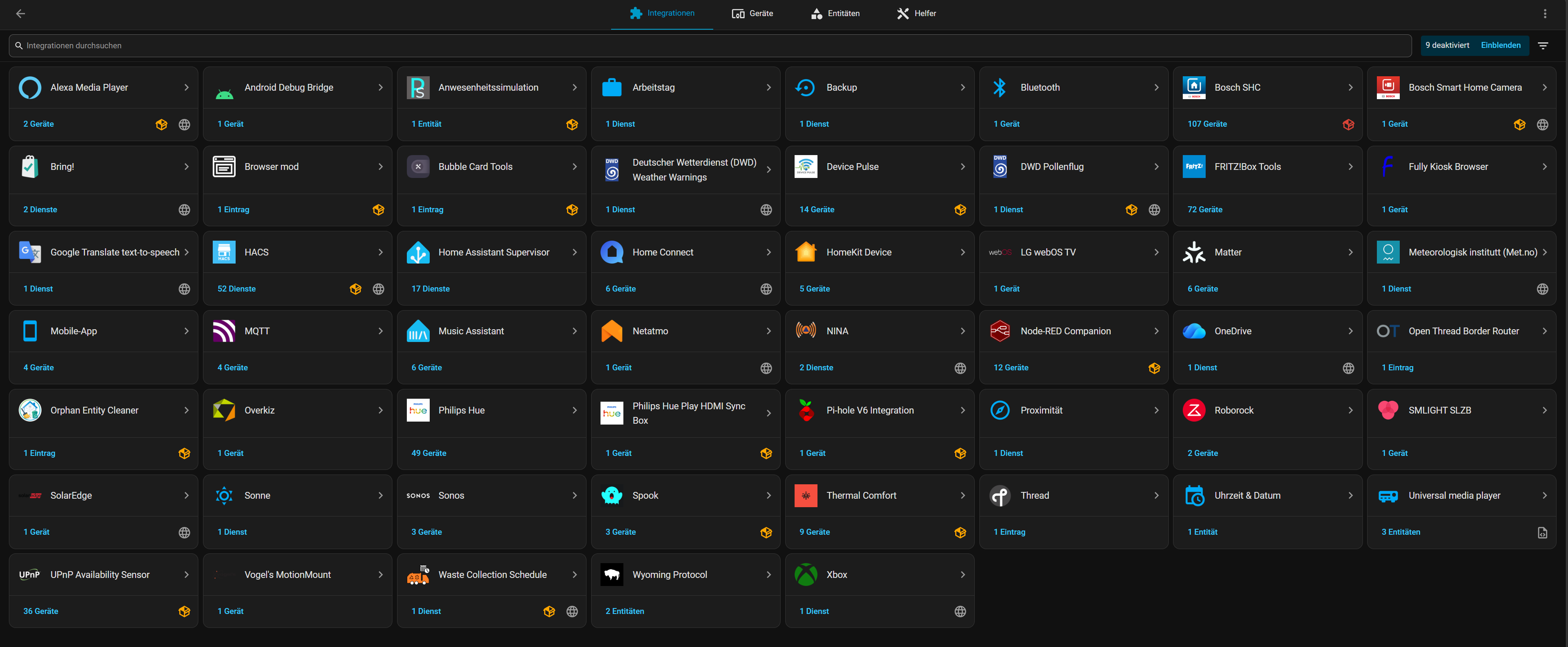

Hmmm... none of the mentioned are active within the integration section. I can also not add them manually.
I add my fully configuration.yaml...

Good news: your default_config: already loads everything needed, so there is nothing to add by hand. Not being able to add them from the integration list is actually the expected behaviour — default_config provisions them automatically and HA hides them from the "Add integration" search for that reason. They are not missing.
Quick clarification on the three pieces:
  • go2rtc — on HAOS and Container installs this appears as its own entry under Settings → Devices & Services (since HA 2024.11), with a Reload action. If you don't see it and you're on a Core (bare Python) install, the bundled go2rtc binary isn't included and would have to run separately.
  • stream — silent background component, no tile anywhere. Normal.
  • webrtc — there is no integration with that exact name in the UI. It loads internally when needed, so not seeing it in the list is fine.
The more likely reason you always land on HLS, even at home, is the URL you open HA with. WebRTC needs a direct connection from the browser to go2rtc; if you reach HA through an external address (Nabu Casa, a DuckDNS name, a reverse-proxy domain) while sitting on your home Wi-Fi, that path counts as remote and the card falls back to HLS.

I'm already on local IP address. But I cannot see a go2rtc integration.

First, the missing "go2rtc integration" is expected, not a fault. With default_config: go2rtc runs as a bundled background process and does not show up as a tile under Settings → Devices & Services. It's still running, which your debug UI on :11984 already proves. Nothing to fix there.
