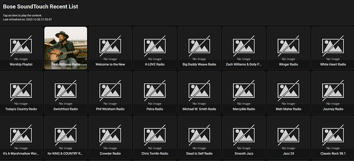

@jasebob Ya, same here … in the SoundTouch App, all of my recently played items are set to generic icons for ALL sources (Pandora, TuneIn, etc). I get the same results when I generate the list from the device using the http://192.168.1.131:8090/recents call as well. Presets are still fine though, just like yours.
This tells me that the Bose SoundTouch device is removing the cover art from the recent list items! I have no idea why it does that - maybe to conserve space as some image url’s can be quite long? Maybe it’s due to the fact that most image art url’s are from a CDN source, and are temporary in nature; e.g the device verifies the image url’s before returning them in the recents list, and they may no longer exist since they are on a CDN source? Maybe they remove them due to copyright / digital licensing rights? Not sure on that one.
Here’s my recent list now (it was fully populated with artwork yesterday) - the Zach Williams cover art is due to me playing that Pandora station today.
As it happens, I did receive a free 90-day trial offer from Spotify for a premium account a few days ago. I think I will get signed up for that, and try to figure out the station list navigation at least.
Wish I had better news on the recents list.

So the really nasty solution is to Cache the ContainerArt and match it to the location string. But that needs non-volatile storage for the integration and would be a lot of work.
I just changed the recent selections from a picture-entity to a button card.
Its not as pretty but is very functional and gives access to all the recently played list.
