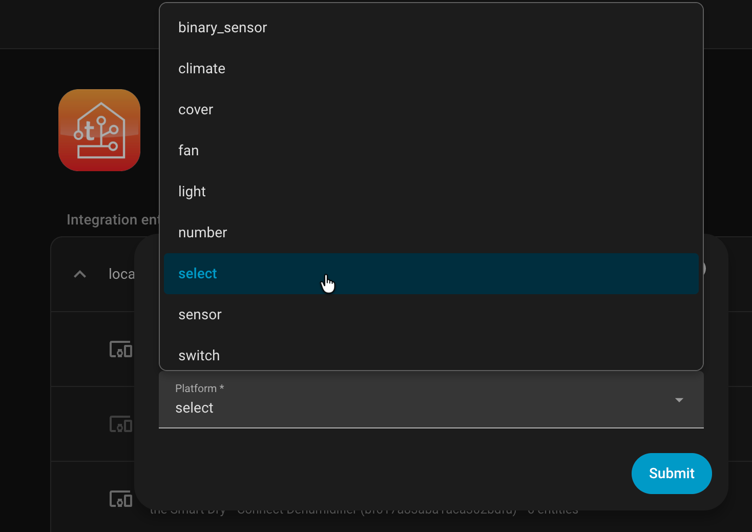

I used the select platform type for DP2 and DP6 instead of number which shows in HA as a drop-down selector automatically. I used similar config to this post Breville Smart Dry Connect Dehumidifier - #13 by Yunseok_Oh

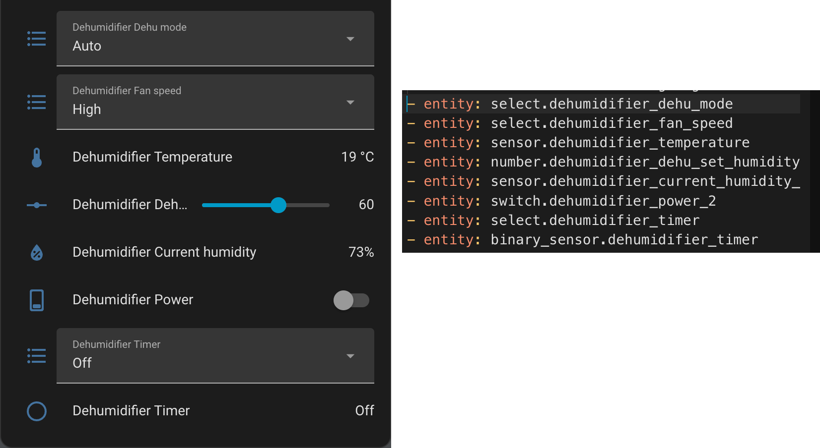

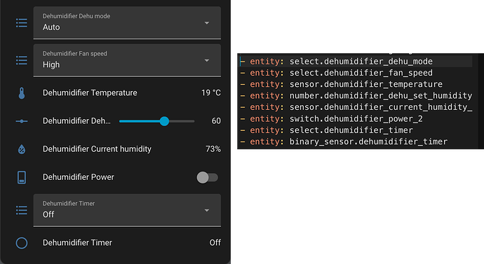

I have the Breville LAD208.
The display below is without the need for any helpers, just straight yaml displaying of the entities.
