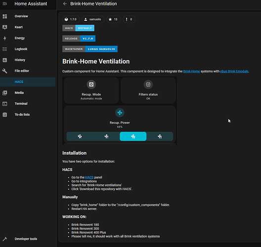

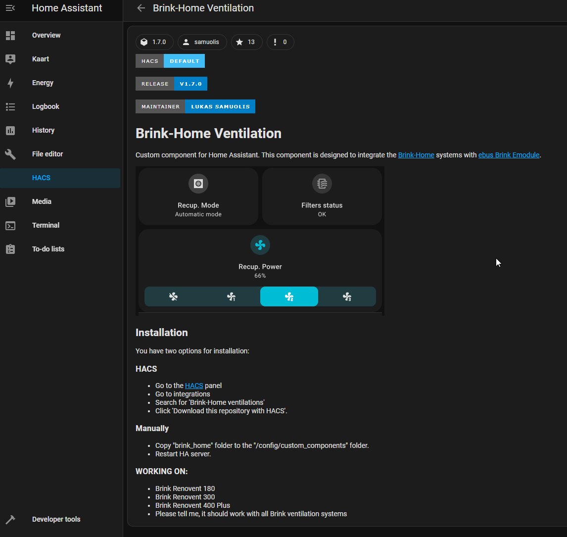

Hi, i’ve installed this integration with HACS, but I can’t find out how i can configure it. How do i connect it with my Brink 300 (with brink-home)?
You need to use the same login as in this page:
https://www.brink-home.com/idsrv/account/login?ReturnUrl=%2Fidsrv%2Fconnect%2Fauthorize%3Fclient_id%3Dspa%26redirect_uri%3Dhttps%253A%252F%252Fwww.brink-home.com%252Fapp%26response_type%3Dcode%26scope%3Dopenid%2520api%2520role%2520locale%26nonce%3Ddaa91109a42e595105854f2d9beb15c935i4zhhDO%26state%3D996779defd1b5fd0b27bf1ab3cd234d797bsvYNtP%26code_challenge%3DYTq5X-anzJ0A9zpjKD1YqEJEuyACoE4d5oUDf4n9mfE%26code_challenge_method%3DS256%26lang%3Den
If you have access through ebus module, than it should work with this integration
Thanks for the reply! Where do i fill in the credentials? I already thought i have to fill in the credentials somewhere, but I don’t see anywhere the options to login/connect it with brink-home.
You can now just search for integration called brink-home and there will be input for username and password. It should allow you to connect to your fan and control it
I have already downloaded it with HACS. It doesn’t show any option to login.
Now you need to go to setting → integrations → plus sign → select brink-home → submit credentials.
What you see here is just an update entity of hacs integration, not integration itself. Which is in settings, like any regular philips hue, zha, google or homekit integrations. Hacs is just to install integrations, to setup you need to use regular process though settings
Thank you so much! I got it working on a Brink Flair 300 (which is connected with wifi to brink-home). Perfect!
