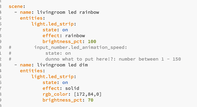

Quick one, how do I set the animation speed as part of a scene? I’m wanting a slow rainbow for some scenes and a quick one for others. I can set the speed using the input slider, but it will always default to the last value.
Am I right in thinking I need to have the input_number slider as below, but insure how to set the value of the automation speed?
Ive tried changing state to a number between 1-150, using value: 1-150 and step: 1-150 but none of them work. Any ideas? (commenting out in the below example as it wasn’t working so disabled it…)
You might want a script rather than a scene and use an action that set the wish value to the input_number:
  service: input_number.set_value
  data_template:
    entity_id: input_number.led_animation_speed
    value: 30
This should trigger the automation watching input_number.led_animation_speed value change, and send the new value to your lamp.
