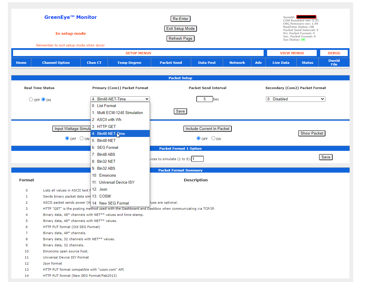

I added the custom repo to HACS, downloaded, and then installed the integration. I even restarted HA just in case, but Iām just seeing this. Did I miss a step? Just to add - Iām using a Dashbox, and set port forwarding to the HA server on port 8000.
Thatās a known issue when you click the configure button; thereās nothing left to configure after youāve added the integration. Once it receives a data packet from your DashBox it will add entities for all of the sensors. So it seems that something is not quite right with the GEM/DashBox setup, such that packets arenāt arriving at whatever port the integration is configured to listen on, or else the packets arenāt of the right format (they need to be one of the BIN formats). If you double check all of the configuration and itās still not working, file an issue over at the GitHub page for this integration, making sure to include all of the diagnostic information that the issue template asks for, and weāll go from there!
Ok - thanks for the response. I suspect itās the wrong format packets. I need to get into the GEM to check that, but itās been YEARS since I did that, and the credentials I expect should be working are not. That has nothing to do with this integration though, and Iāll figure it out eventually or ask for help on the Brultech forum. Iām excited to get this integration working.

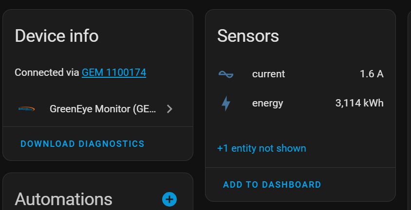

With much help from Ben, I got my GEM and Dashbox updated to the latest software / firmware, and got the integration installed. Itās working, but Iām seeing something very odd. I enabled the current sensor on one channel, and itās showing the correct value. The energy sensor though is crazy high (all of them appear to be) and I have no idea why. Am I reading this incorrectly?
I just noticed something else really odd. This is the exact same sensor as the previous screenshot, but the current draw is lower (and matches what the Dashbox page is showing). BUT - I just noticed that the energy reading is still exactly the same.
Itās just reporting whatever the GEM is. I believe you can reset the energy counters in the GEM itself, but I wouldnāt bother. Home Assistantās energy dashboard looks at how much the energy value changes per time period, and doesnāt care about absolute values.
Re the energy sensor not changing:
- At 1-2A, itāll take somewhere between 2 and 10 hours to use a kilowatt-hour of energy, depending on what the voltage is
- The energy sensors are only updated once every 30 minutes so as not to overwhelm Home Assistantās database while still giving plenty of data for the energy dashboard.
Got it - that makes sense. Thanks! ![]()
