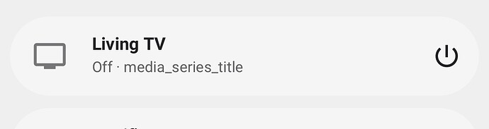

I’ve tried to get this to work, but no background is shown after changing the entity name for background-image. Does this rely on integrations support for coverart?
Do you have a cover that is displayed where the icon should be? Because if your entity don’t display any cover it will not work indeed.

Thanks, that’s what I figured. Sadly the CSS change didn’t work in the theme and was hoping there was some solution. I guess I’m sticking to the stupid grid card.

I got it to work with one of the integrations, thanks. Although, it doesn’t work with another. The integration that’s not working just shows channel icon and not the programme artwork, maybe that’s the issue?
