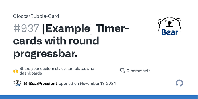

Done so, it took some work to get the timer functionalilty working.
Here it is:
