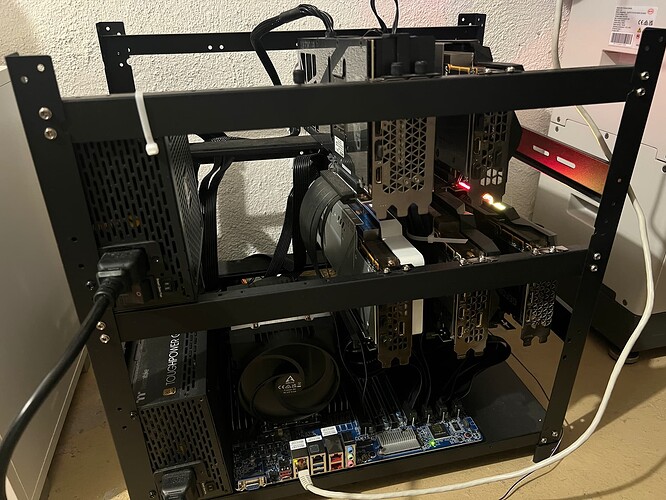

Using old PC parts and my first used RTX 3090, I’ve now built a full‑blown LLM rig: 4 × RTX 3090 plus a RTX 5090 (the latter for rapid STT, TTS, and AI‑image generation). I’m finally at a point where I can say the local Jarvis is almost done. Thanks to the hardware, I’ve moved from great models like Gemma 3 and Mistral 3.2 to GPT‑OSS‑120B, which works beautifully with Home Assistant. Since GPT‑OSS lacks vision, I’m also running Gemma 3 to analyze camera images.

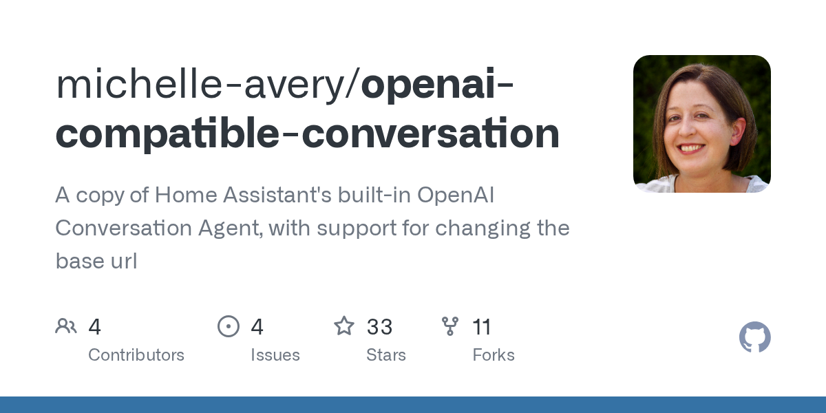

What I’d love most right now is an OpenAI‑compatible API integration with a custom endpoint. In the LLM world, the OpenAI API is the de‑facto standard, and I’d love to plug it directly into Home Assistant (please, please). There is a custom integration*, but it doesn’t perform as well as the native Ollama integration.

(Here again I’d love a custom OpenAI‑API endpoint to hook in back‑ends like LLAMA.CPP or VLLM. Custom integrations exist in theory, but they’re flaky; I’ve wasted too much time on them. The native Ollama integration works reliably for now.)*

- **Open AI API custom endpoint (Many thanks Michelle )

Picture off my LLM monster
