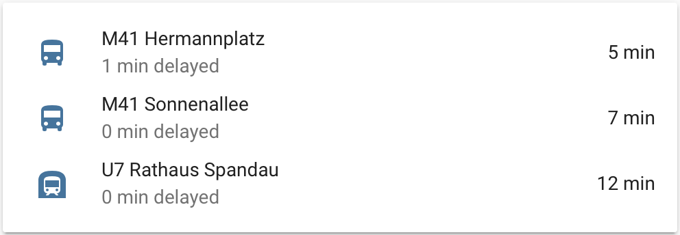

I’ve had trouble setting this component up as well so I created a fork and migrated the repo to the new component structure required since “The Great Migration”. Additionally the API endpoint had changed so I made some minor tweaks there. It is now working correctly again.
Just make sure to rename the folder to bvg
after cloning/unpacking the repository.
If fluffykraken wants to continue maintaining the component I am happy to submit a pull request. Perhaps the documentation would need some additional changes so just let me know if you encounter any issues.

- I don’t know of any custom lovelace card if that’s what you’re looking for but feel free to create something if you have an idea
at the moment I am just using an entities card with secondaryinfo-entity-row to display the delay

here’s an example:
- type: entities
entities:
- type: custom:secondaryinfo-entity-row
entity: sensor.bvg_moritzplatz_u8_wittenau
secondary_info: "[[ sensor.bvg_moritzplatz_u8_wittenau.attributes.delay ]] min delayed"
