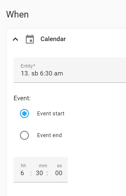

As trigger I select one of the calendars, let’s use the example of wake-up SB 6:30 am:
As these are all-day events, meaning the event starts at midnight, I entered 6:30 off-set (after).
For action I use the relevant script that I created earlier.
Because we sometimes wake up at a non-regular time, I also have a calendar wake-up once and for that I will have to set the off-set every time it is needed, but I can use the existing script.
For other calendars, like cleaning lady day and trips I do not need a script and have specific actions for each.
I am not, in the slightest, claiming that my construction is better than @Blacky 's. In fact, his Blueprint is way more sophisticated and detailled. But with the use of all-day events, my construction works for me and is an alternative.
