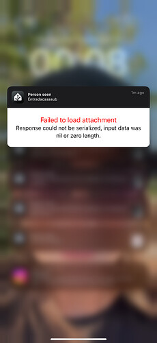

I really like the idea of this!! Very cool and fun! However, for me I just get “Person seen” and no other text at all in my notifcations. Maybe the screenshot here is a hint? I have no idea how to troubleshoot…

So I figured out what my problem was. Turns out under “model” I had to put “gemini-1.5-flash” … I assumed “Leave blank to automatically detect the best model.” would choose something that works, but it didnt. Maybe this can help someone else :slight_smile:
