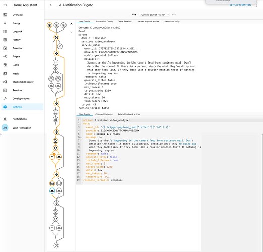

I’m trying this out and I get so far that I get a notification with only “Person seen” and the camera name with a snapshot. I do not get any AI information
alias: AI Notification Frigate
description: ""
use_blueprint:
  path: valentinfrlch/event_summary.yaml
  input:
    mode: Frigate
    notify_device:
      - XXX
    camera_entities:
      - camera.uppfart
    object_type:
      - person
    provider: XXX
    model: gemini-1.5-flash
    max_tokens: 90
    cooldown: 1
    preview_mode: Snapshot
In traces it shows this
I also have this error message and the automation is stuck never completing
Logger: homeassistant.components.automation.ai_notification_frigate
Source: components/automation/__init__.py:664
integration: Automation (documentation, issues)
First occurred: 18 January 2025 at 09:22:46 (3 occurrences)
Last logged: 18 January 2025 at 22:31:23
Error rendering variables: UndefinedError: 'dict object' has no attribute 'payload_json'
Same here, also getting this exact same error nowadays but at least the automation still works, and I get the AI summary.
I get the exact same error with the blueprint now. It worked previously well. Then I moved my frigate server and reinstalled everything from scratch in home assistant (including MQTT broker). Now it seems the automation does never trigger and leaves the above error in the log.
Seems indeed related to latest version. I rolled back to 1.3.5 and the automation works like a charm.
I’m running 1.3.5 on the blueprint and I’ve always had that issue
In fact, it came back… I ran the 1.3.5 and all notifications started to flow. Then after a while the error appeared again. I then upgraded to 1.3.7. and downgraded again and it worked again. After a while, it stopped again. I will let it run for a while to see if it is just intermittent. It’s an odd one to reproduce.
