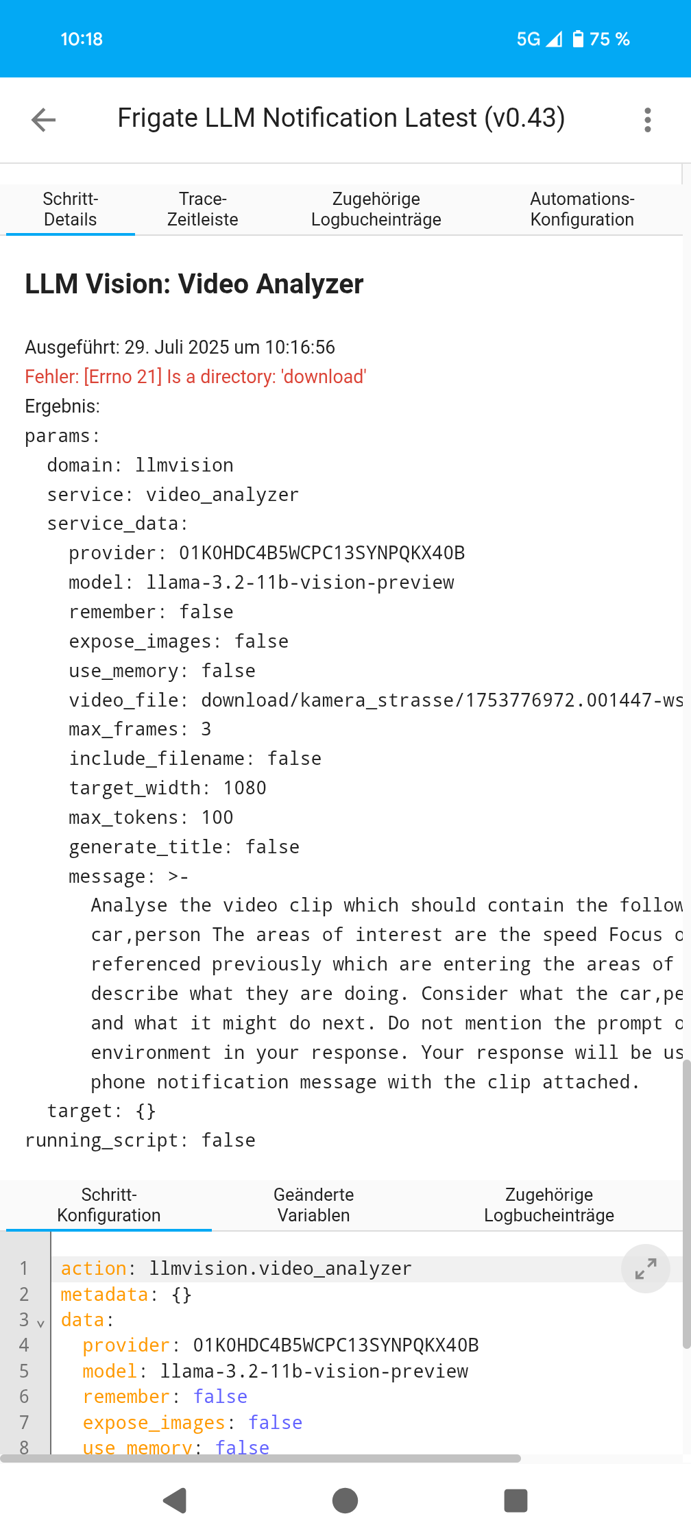

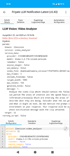

hi is your downloader integration setup to use “downloads” folder? If so, try removing config
I set up downloader to use the folder “download” this folder is setup in config/download.
I use home assistant in docker is there a difference to hass os installation?
When I only use download instead of config/download I get the error shown below
hi is the file present in the “download” folder?
can you provide a full trace?
