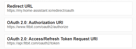

Since home assistant sets the Oauth redirect url to always Link to OAuth2 Authorize Callback – My Home Assistant that means that this url should also be set on fitbit app config. If you set it to something else then you get the error: Developer information: invalid_request - Invalid redirect_uri parameter value
