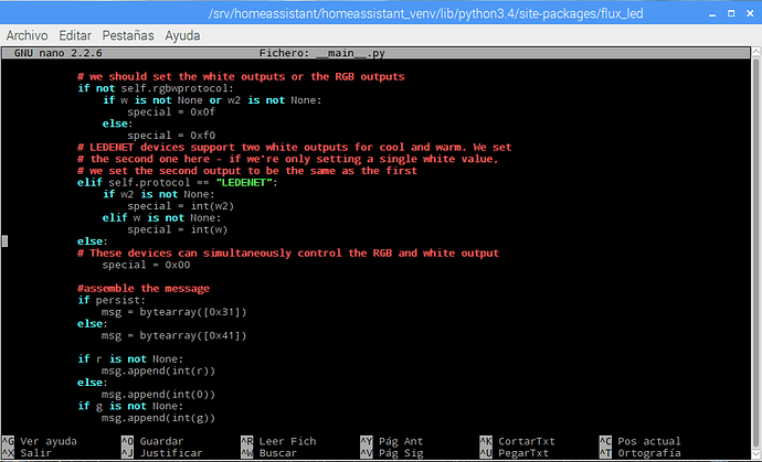

Adding a extra byte works for me:
EDIT:
The last sources of the official repository Danielhiversen/flux_led work correctly, apparently the sources in home assistant are not the last version.
Test Danielhiversen/flux_led OK:
fux_led in home assistant:

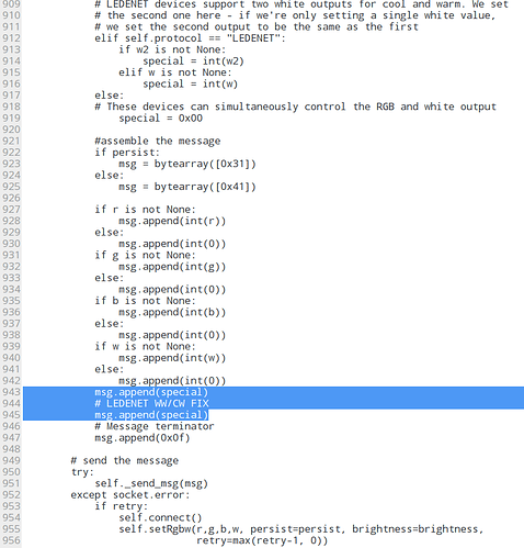

Temp correction:
Duplicate line 943 in the file /srv/homeassistant/homeassistant_venv/lib/python3.4/site-packages/flux_led/__main__.py (this path depends on the installation of home assistant)
Diff (between the lines 900 ~ 944):
We need to validate how to update the library in Home Assistant,
