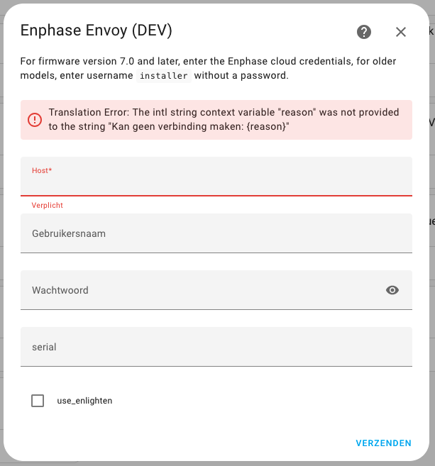

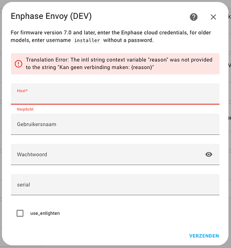

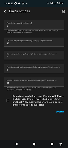

My own house I have software 7.6.175, single phase, also Envoy-S-Standard-EU but with the standard integration and integration from briancmpbll (“Enphase Envoy (DEV)”) it’s not working…
What am I doing wrong?
I’ve ticked the box at the bottom. Strange it doesn’t tell me what it is for…

The chances are your problem is not the same as the one 2 years ago (in fact I’m sure it is not) so you’d best create a new topic for this.
In that topic, describe what you did. The screenshot shows empty fields, if that is what you did than indeed it will not work. So I dare say you did something else.

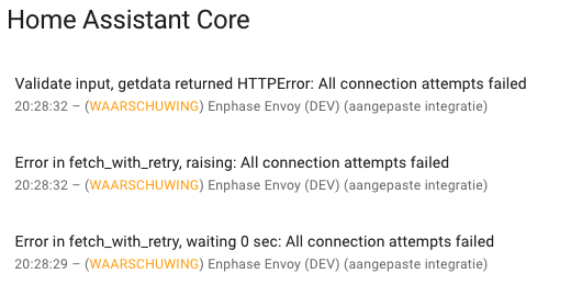

It’s getting an http error when trying to connect to the Envoy. Add below to your configuration.yaml:
logger:
  default: warning
  logs:
    custom_components.enphase_envoy: debug
    httpx: debug
    httpcore: debug
restart HA and then try adding it again. Then check home-assistant.log if there’s more detail on the issue.

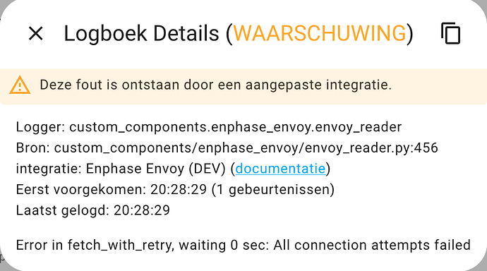

Ha, nice that you want to think along. I followed your advice. Below the prt screen of the relevant log lines.
afbeelding
All connection attempts failed mean it can’t find the envoy on the network.
Did you enter the correct ip address in the Host field?
If you enabled debug you may find more info in homeassistant.log file, use settings - system - logs to the download log from HA

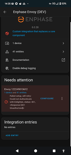

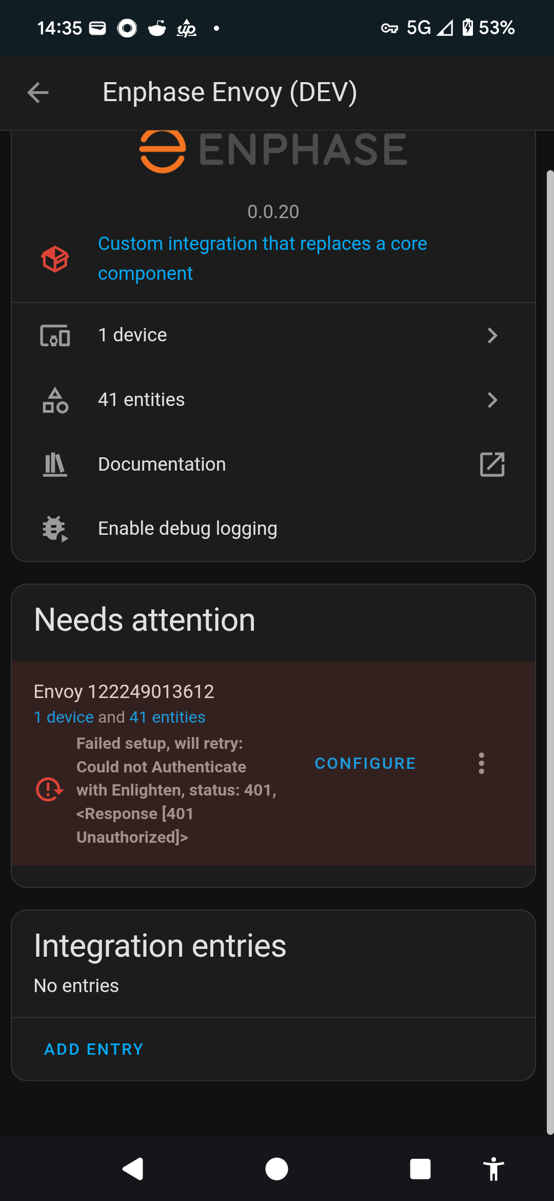

My integration is giving me a 401 error at the moment but I dont have the option to update username or password
And I’m not 100% sure if I used a token, how can I check?
