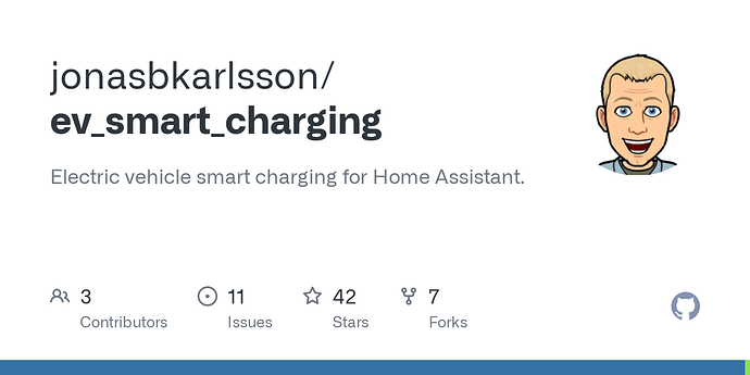

Just spotted a new custom integration that might help?
