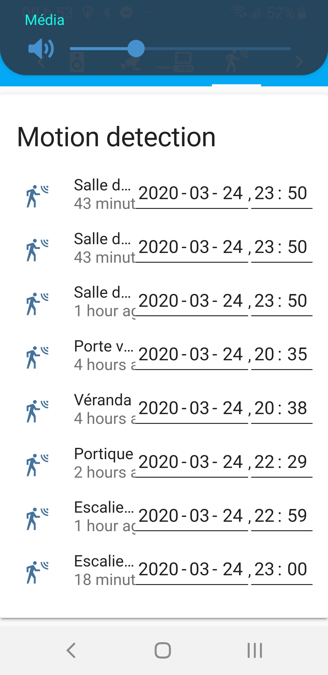

Trying hard to change the font size, margin, padding of an input_datetime element. I wonder if anyone could shed some hint on how to achieve my goal. I would like to reduce the size to better fit my phone screen (see image). Anyone did something similar ??
entities:
  - entity: input_datetime.modetect_l0_sdb
    icon: 'mdi:motion-sensor'
    name: Salle de bain sous-sol
    secondary_info: last-changed
TIA
I have similar setup. You don’t need your input_datetimes to be editable, do you?
If you don’t, don’t expose them in fronted. If you really need to, wrap them in template_sensors.
To sum it up: don’t think you need all the information in one place (provided you show that last_changed) especially on a small screen so change your UI design.
Here’s what I have as a main card
mot1
and this is a conditional card I display when Debug is enabled (as you can see, no input_datetimes, they’re all in HA only).
Screen Shot 2020-03-25 at 07.15.05 (2)
Hope that helps.
