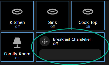

I am new to ccs styles and having a challenge identifying the primary an secondary text attributes. I would like to change font characteristics. I have attempted with the code below using card-mod. I have added the following command --primary-font-size: 10px !important; with no effect on the text font size. This is a tile card. I have had no issues with the custom button card changing the font size and color. Appreciate any assistance or guidance.
tile_card
      - features:
          - type: light-brightness
        type: tile
        entity: light.breakfast_chandelier
        card_mod:
          style: |
            ha-card
              border-radius: 2px;
              font-family: 'Verdana';
              border: solid 3px;
              border-color: rgba(82, 144, 195, 1);
              height: 115px !important;
              width: 269px;
              background: rgba(0, 0, 0, 1);
        vertical: false
        show_entity_picture: false
        icon: mdi:chandelier

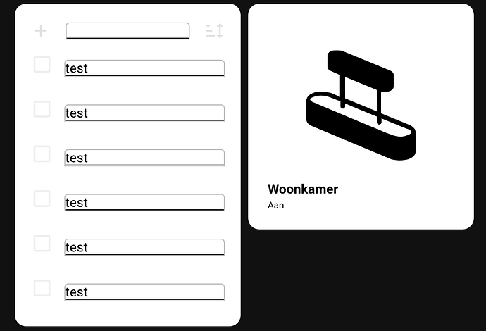

I hope that somebody can help me out with this one. I’m trying to create a new dashboard with square tiles and I was working on the Shopping list card. I did some modifications with card mod which I found on the web and in this thread. Unfortunately I’m stuck…
I would like to achieve the following:
  1. Keep the card as a square. Add a scrollbar instead of making the card longer.
  2. Have a border only around the first input text field instead of the items added to the list.
  3. Have less space between the items on the list.
Unfortunately I’m not able to figure this out and I hope somebody can help me with this. Thanks in advance!
              - type: shopping-list
                style:
                  ha-textfield:
                      .mdc-text-field__input {
                        color: black !important;
                      .mdc-text-field {
                        --mdc-text-field-fill-color: white;
                        border: 1px solid rgba(127,127,127,0.5);
                        height: auto !important;
                        --text-field-padding: 0px 0px;
                      ha-card {
                        background: white;
                        box-shadow: none;
                      :host {
                        --mdc-text-field-idle-line-color: black;
                        --mdc-text-field-hover-line-color: cyan;
                        --mdc-theme-primary: black;
Edit:
I found the solution for most the problems, except for the border around the text input at the top of the card.
            style:
              ha-textfield:
                  .mdc-text-field {
                  ha-card {
                    --mdc-typography-subtitle1-font-size: 11px;
                    background: white;
                    box-shadow: none;
                    height: 234px;
                    width: 100%;
                    max-height: 234px; /* Set a maximum height for the card */
                    overflow-y: auto; /* Enable vertical scrolling if content exceeds max height */
                    @media (max-width: 767px) {
                    height: 194px; /* Adjusted height for mobile */
                    max-height: 194px; /* Set a maximum height for the card */
                  :host {
                    --mdc-checkbox-ripple-size: 20px;
                    #--mdc-checkbox-state-layer-size: 5px;
                    --mdc-text-field-idle-line-color: grey;
                    --mdc-text-field-hover-line-color: red;
                    --mdc-theme-primary: grey;
