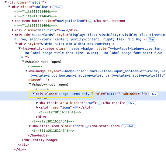

I added a badge to the header and want to use card_mod to remove the badge’s background. However, there’s no ha-card element in the DOM. Is it possible to modify it?
header_cards:
  badges:
    - type: entity
      show_name: false
      show_state: false
      show_icon: true
      entity: input_boolean.sleep_mode
Thanks.

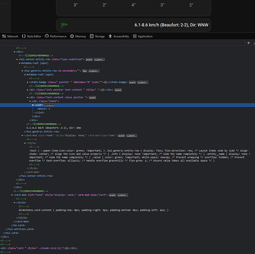

Dear Chris,
Sorry to bother you again but following our exchange on Nov 25th my your card-mod code worked well, but when I upgraded core yesterday my wind speed went back to white. I’ve looked at the html before and after but can’t understand what has changed? Any thoughts would be greatfully appreciated.
Here is the html:
I tried changing .entities-row to .hui-generic-entity-row, but that hmade no difference?
Many thanks - Colin
Update: from 7th Dec.
It now works on my PC using Firefox but not in the companion apps on phone or tablet nor in Android Firefox? I’ll just wait to see if it sorts itself out!
