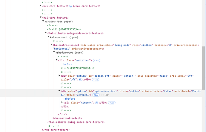

I am trying my darnest to change the color of the ā€˜swing’ button on the theromstat card (yellow arrow pointing to it in my screenshot). My yaml is below and the html I am going off is also attached.
I have read the docs and still can’t manage to do it!
Would appreciate any help!
type: thermostat
entity: climate.living_room
features:
  - type: climate-hvac-modes
    style: icons
    hvac_modes:
      - "off"
      - heat
      - dry
      - fan_only
  - type: climate-fan-modes
    style: dropdown
    fan_modes:
      - auto
      - speed 1
      - speed 2
      - speed 3
      - speed 4
      - speed 5
      - speed 6
  - type: climate-swing-modes
    style: icons
    swing_modes:
      - "off"
      - vertical
name: CUSTOM TEMP CARD
show_current_as_primary: false
card_mod:
  style: |
    hui-card-features$
        hui-card-feature$
           hui-climate-swing-modes-card-feature$
              ha-control-select$: |
                   #option-vertical.option.selected {
                            --control-select-color: red !important;

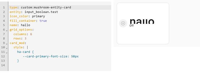

I am new to using the card-mod features
I just want a larger text and icon on certain buttons)
but the text seems to be cut-off
how can I fix this?
how do I get the icon bigger?

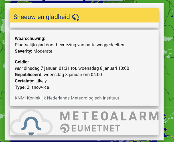

In meantime, checking more of my dashboard I noticed the same issue with markdown card placed within grid card… also lost transparrent background. Again 3.4.4 fixed this, so also for this I’ll wait for next release.

this is the element to target now:
