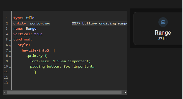

Hi Thomas,
I would like to use your card-mod.
Just want to increase the font size
What do i do wrong?
type: tile
entity: sensor.wvwfdsae118877_battery_cruising_range
vertical: true
card_mod:
  style: |
    ha-card {
     font-size: 4em;
This is one method…
type: tile
vertical: true
card_mod:
  style:
    ha-tile-info$: |
      .primary {
        font-size: 1.55em !important;
        padding-bottom: 8px !important;
Thx @LiQuid_cOOled , that increases already,
But how do it get the kilometers also increased? :slight_smile:
You are exceeding the standard line height. You’ll need to make additional adjustments like increasing the card height or stealing space within the card.
card_mod:
  style:
   ha-tile-info$: |
    .info {
      height: 4em!important;}
    .primary {
      line-height: 1.55em !important;
      font-size: 1.55em !important;}
    .secondary {
