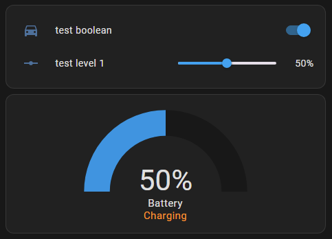

Additional label on Gauge card
code
type: vertical-stack
cards:
  - type: entities
    entities:
      - input_boolean.test_boolean
      - input_number.test_level_1
  - type: gauge
    entity: input_number.test_level_1
    card_mod:
      style: |
        .name:after {
          {% if is_state('input_boolean.test_boolean','on') -%}
            {%- set STATUS = 'Charging' -%}
            {%- set COLOR = 'var(--accent-color)' -%}
          {%- else -%}
            {%- set STATUS = 'Discharging' -%}
            {%- set COLOR = 'var(--red-color)' -%}
          {%- endif -%}
          content: "\A {{STATUS}}";
          white-space: pre;
          color: {{COLOR}};
Alternatively - use auto-entities (but it has own issues).
