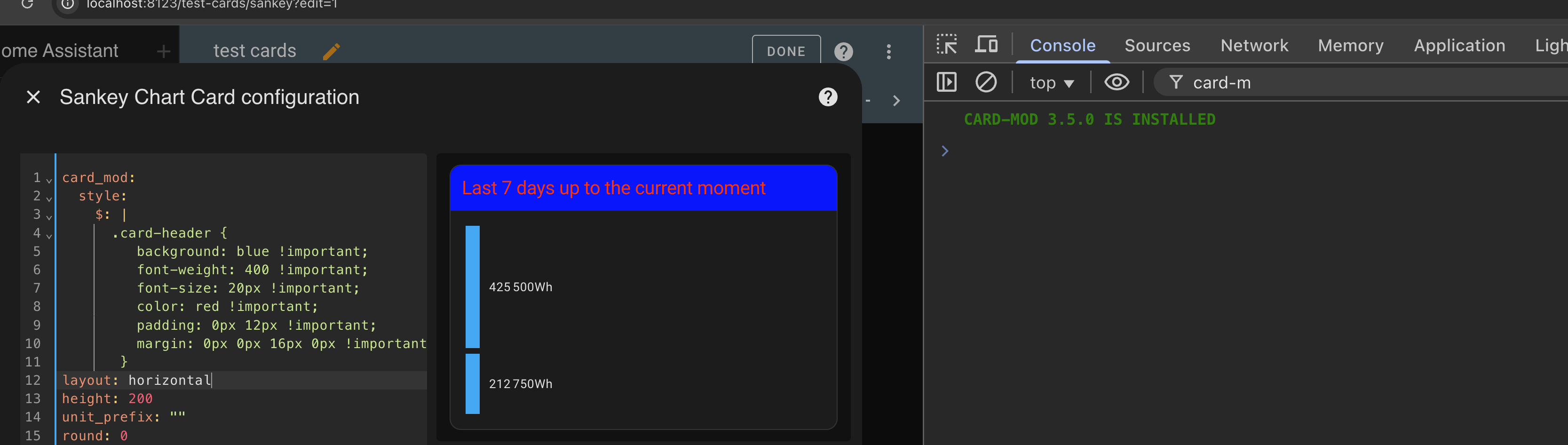

I can no longer mod the title (.card-header) of the Sankey chart card (custom one)
as you can see in the same screenshot. Energie verbruik.
It was changed some time ago, but then we (arganto and I) managed to find a reliable mod somewhere above in this thread.
But I now noticed that is lost again. Maybe you can find a way to touch the card-header once again?
I don’t use Sankey card. I don’t know what the config looks like from it, is the header the default from the card? Show me part of the config, I will download Sankey and take a look at it… :wink:
thx.
yes indeed:
type: custom:config-template-card
entities:
  - input_select.sankey_min_state
variables:
  min_state: states['input_select.sankey_min_state'].state
card:
  type: custom:sankey-chart
  title: Energie verbruik
I did take the config-template-card out to see if that causes trouble, but even then the header remains unmodded…
this is the Dom, hope you can see it:
and, when entering there, there is no problem.
I am using card_mod 3.5.5, but even with the current 3.4.4 release, it seems unreliable to mod.
(of course I did try to set the ha-card element in the 3.5.5 way too, but that didnt help, so I wont mention it further here not to confuse the thread)
note this is the custom GitHub - MindFreeze/ha-sankey-chart: A Home Assistant lovelace card to display a sankey chart. For example for power consumption card, not the current experimental built-in energy sankey card
I dont get it, as the custom card itself seems to not have changed those detail at all

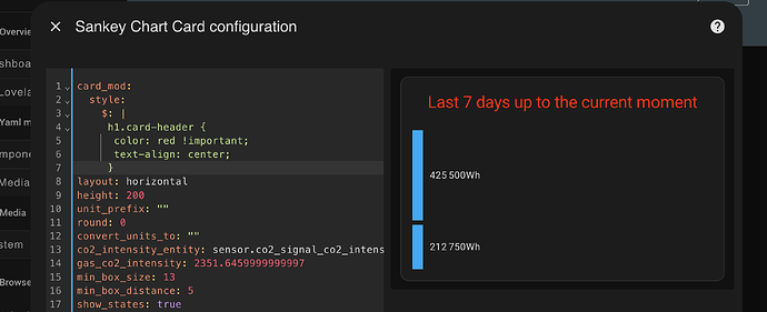

try this…
card_mod:
  style:
     h1.card-header {
      color: red !important;
      text-align: center;
I will, but now notice my
      card_mod:
        style:
              .card-header {
                   background: var(--background-color-off) !important;
                   font-weight: 400 !important;
                   font-size: 20px !important;
                   color: var(--text-color-off) !important;
                   padding: 0px 12px !important;
                   margin: 0px 0px 16px 0px !important;
on 3.4.4 does work after all.
How odd.
Let me see if it was a temporary fluke, or that I need to rethink 3.5.0 (it mostly only needs an extra ha-card before this, so should work…)
:grinning: :man_shrugging:
I will try with 3.5
@Mariusthvdb
please because I cant make it happen… Maybe DM me if you find it, so we doing disturb the crowd ?
