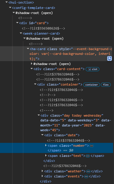

I try to apply a card_mod style to a card that has another card.
Code snippet that doesn’t work:
      - type: custom:config-template-card
        entities:
          - input_text.birthdays_calendar_filter
          - input_select.calendar_view
        card:
          type: custom:week-planner-card
          calendars:
            - entity: calendar.name
          days: 28
          startingDay: today
          startingDayOffset: 0
          hideWeekend: false
          noCardBackground: false
          compact: false
          weather:
            showCondition: true
            showTemperature: true
            showLowTemperature: true
            useTwiceDaily: false
            entity: weather.forecast_thuis
          locale: en
          showLocation: false
          hidePastEvents: false
          hideDaysWithoutEvents: false
          hideTodayWithoutEvents: false
          combineSimilarEvents: false
          showLegend: false
          showNavigation: false
          grid_options:
            columns: full
          card_mod:
            style: |
              .today .number {
                background-color: teal;
Removing the top card makes it work:
        - type: custom:week-planner-card
          calendars:
          days: 28
          startingDay: today
          hideWeekend: false
          compact: false
          weather:
            showCondition: true
          locale: en
          showLocation: false
          showLegend: false
          grid_options:
            columns: full
          card_mod:
            style: |
              .today .number {
Here’s a screenshot of the dev console:

I have taken a look and what you are seeing stems from the fact that week-planner-card does not have a _config variable for card-mod to query when it looks up the DOM tree from ha-card. This is same as for the recently popular ring-tile-card.
card-mod does keep trying to look for an element that has the config related to the ha-card it patches from (in v4 this starts with hui-card by preference). When used in standard Frontend way a parent card in the DOM will be hui-card which has copy of config to manage things like visibility. card-mod finds this config and all is well.
A lot of custom cards do not wrap with hui-card and as such, card-mod search expires and there is no config found. This is what you are seeing. Usual workaround is to wrap in a card that uses hui-card. e.g. a stack card or grid - when containing a single card the output is the same, but card-mod can find the copy of config that hui-card contains.
Extra Reading: card-mod and config
