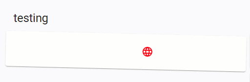

A useless animation example:
sss
Starring:
  • entities card
  • dummy-entity-card
  • card-mod
type: vertical-stack
title: testing
cards:
  - type: entities
    entities:
      - type: 'custom:dummy-entity-row'
        entity: sun.sun
        icon: 'mdi:web'
        style:
          state-badge:
              ha-icon:
                  ha-svg-icon {
                    color: red;
                    animation: move 3s linear alternate infinite;
                  @keyframes move {
                    0% {
                     left: 0px;
                    100% {
                      left: 408px;
    style: |
      ha-card {
        animation: wobble 3s linear alternate infinite;
      @keyframes wobble {
        0% {
         -webkit-transform: rotate(-5deg);
        100% {
          -webkit-transform: rotate(5deg);
