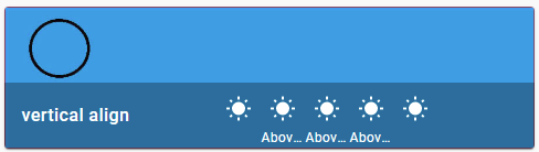

How to align text vertically for the title (+ resizing the footer):
If states are displayed, then the title may be not aligned vertically:
To align it vertically, set the "line-height" property = height of the footer (should be measured via Inspector):
type: picture-glance
title: vertical align
image: /local/images/blue_low.jpg
entities:
  - entity: sun.sun
  - entity: sun.sun
    show_state: true
  - entity: sun.sun
    show_state: true
  - entity: sun.sun
    show_state: true
  - entity: sun.sun
style: |
  .box .title {
    line-height: 52px;
