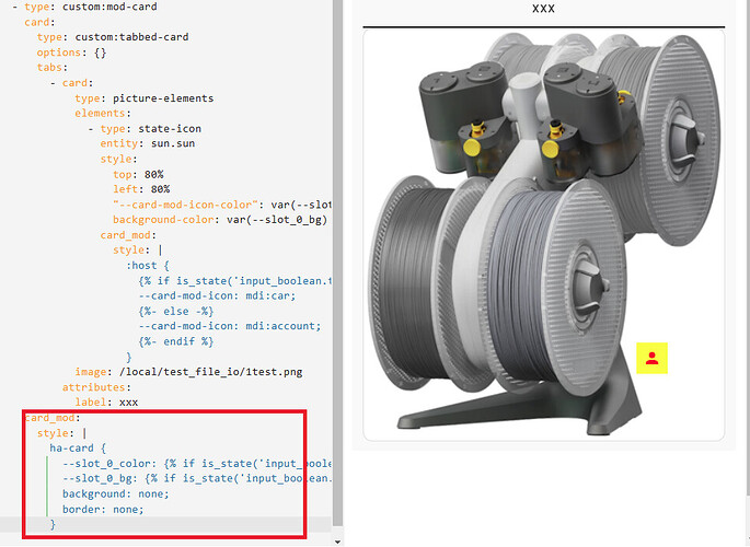

Inside tabbed card:
type: vertical-stack
cards:
- type: entities
entities:
- input_boolean.test_boolean
- type: custom:tabbed-card
options: {}
tabs:
- card:
type: picture-elements
elements:
- type: state-icon
entity: sun.sun
style:
top: 80%
left: 80%
"--card-mod-icon-color": var(--slot_0_color)
background-color: var(--slot_0_bg)
card_mod:
style: |
:host {
{% if is_state('input_boolean.test_boolean','on') -%}
--card-mod-icon: mdi:car;
{%- else -%}
--card-mod-icon: mdi:account;
{%- endif %}
image: /local/test_file_io/1test.png
card_mod:
style: |
ha-card {
--slot_0_color: {% if is_state('input_boolean.test_boolean','on') %} cyan; {% else %} red; {% endif %}
--slot_0_bg: {% if is_state('input_boolean.test_boolean','on') %} lightgreen; {% else %} yellow; {% endif %}
background: none;
border: none;
attributes:
label: xxx
Have you placed your tabbed card onto another card?

but result still this:
Take MY code and add elements one by one.
First - only 1 tab.
No config-template-card (not needed).
Please post a code))
Are you setting background to a tabbed card?
Then it will not be applied to a picture-elements.

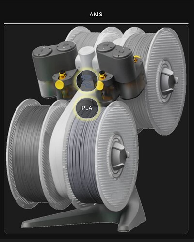

Yes this is the roll icon… I tried to cancel but also roll ran out…
anyway I thank you for your preciuos help and patience…
my page now…![]()
Nice look! I am dreaming about a 3d printer too. Next life may be)
