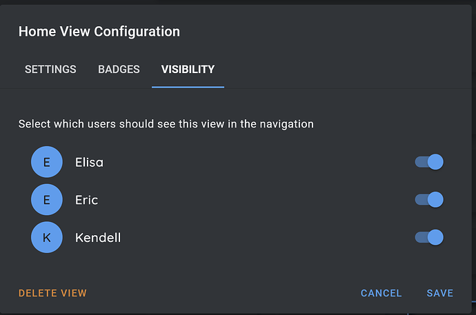

The hide_tabs functionality of Custom Header is now also standard in homeassistant with the visible: option found in the dashboard configuration of your lovelace dashboards.

Is the visible option a new feature of HA 117? I’m still running HA 116.4.
Can’t update to HA117 till they have a revert/fix/solution of this markdown card issue.
This has been in there for a while, UI guide:
