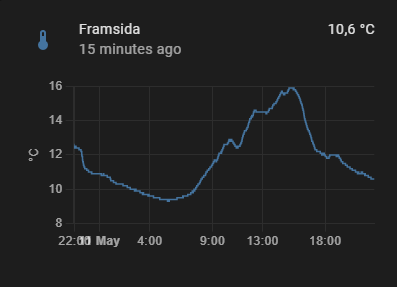

Just the “History” text left to hide
Works perfectly - thanks!
card-mod-more-info-yaml: |
ha-more-info-history $: |
.header {
display: none !important;
.heading {
display: none;
I am speechless. Perfect. Thanks!
It could be a bit different:
.heading ha-header-bar {
display: none;
Otherwise you will not see this panel for some sensors:
So this is just great. Finally I got the more-info to look the way I have wanted for so long. Thanks!
