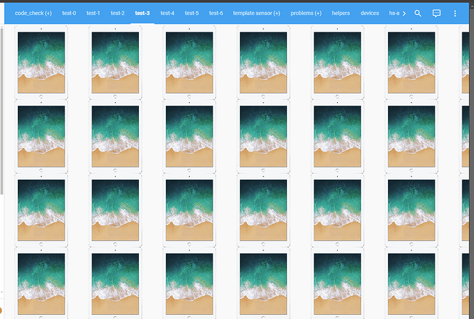

Try
test:
  card-mod-theme: test
  card-mod-view-yaml: |
      hui-masonry-view, hui-sidebar-view, hui-panel-view,
      masonry-layout, horizontal-layout, vertical-layout {
        background-image: url({{state_attr('person.xxxx','entity_picture')}});
You may also use one non-repeated image with this:
background-size: 100% 100%;

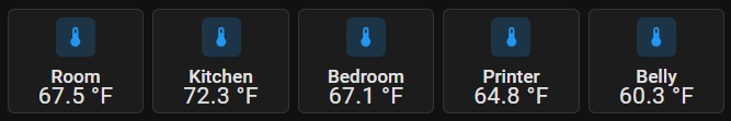

Here is a Mushroom Entity Card displaying my temperature sensors. Looks nice, but I’d like to have the Name text on top, the Icon in the middle and the Temperature on the bottom.
Temp
The Glance Card is just what I want, but I can’t figure out how to make customize the text size like I can do on the Mushroom Entity Card. Here is the Glance Card. I have searched and searched and can’t figure it out.

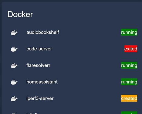

Given the following:
type: custom:auto-entities
card:
  type: entities
  title: Docker
filter:
  template: >-
    {%- for item in states.sensor |
    selectattr('entity_id','in',integration_entities('portainer')) -%}
      {%- if "portainer_server" in item.entity_id -%}
              'type': 'custom:template-entity-row',
              'entity': item.entity_id,
              'name': state_attr(item.entity_id,'friendly_name'),
              'state': item.state,
              'icon': 'mdi:docker'
      {%- endif -%}
    {%- endfor -%}
sort:
  method: friendly_name
I would like the state color to be green if running and red if not running. I’ve had a bit of a challenge trying to find a way to turn the actual item state a color in template entity row. And then what’s the correct syntax to implement that card mod in this auto entities template?

Solution:
Note: config.entity is the entity id in this context found here
card:
  type: entities
  title: Docker
filter:
  template: >-
      {%- if "portainer_sidmesh" in item.entity_id -%}
              'name': state_attr(item.entity_id,'friendly_name') | replace('Portainer SidMesh (local) ',''),
              'icon': 'mdi:docker',
              'card_mod': {
                'style': ".state { background-color: {% if is_state(config.entity,'running') %} green {% elif is_state(config.entity,'created') %} orange {% else %} red {% endif %} }"
      {%- endif -%}
    {%- endfor -%}
sort:
